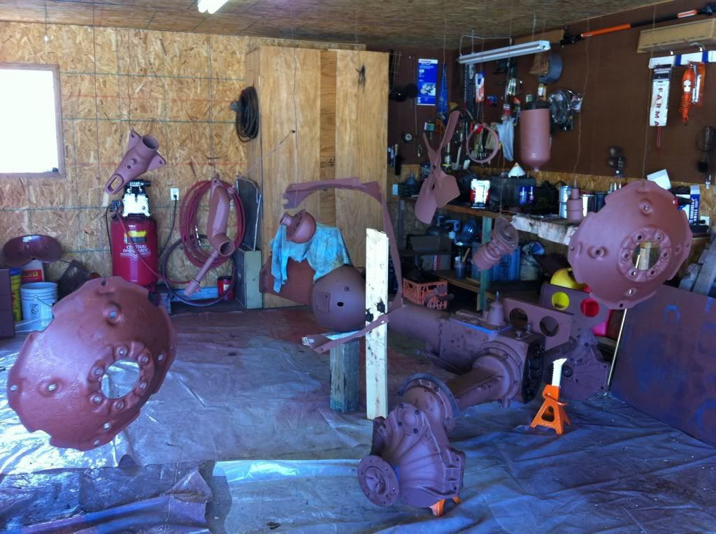

Today I got my motor block mated to the rest of her. And got started on applying the first and second coat of accent color. Now I know it isn't original and that may be frowned on since I completely disassembled the tractor replacing most all seals and any worn bearings. To go and paint it non original. Just for any record keepers I love the red but when your then 5 year old daughter ask you to paint it her colors I put the red aside for a slightly lighter shade . I haven't got to it yet but the accent color of smoke grey has been applied to most of the parts receiving it. So here goes progress .

Not sure what the Cultivision decal looked like, but i will search it up. My vision was the Circle with the K in the middle but right under the K in the circle put FOR KELSEY . I am also having a delete plate made for the back of the transmission to take the PTO and Belt Pulley off and going to do something on that flat surface. still a work in progress. should have more pics coming soon want to have it ready for a local show on the 13th and 14th of April.

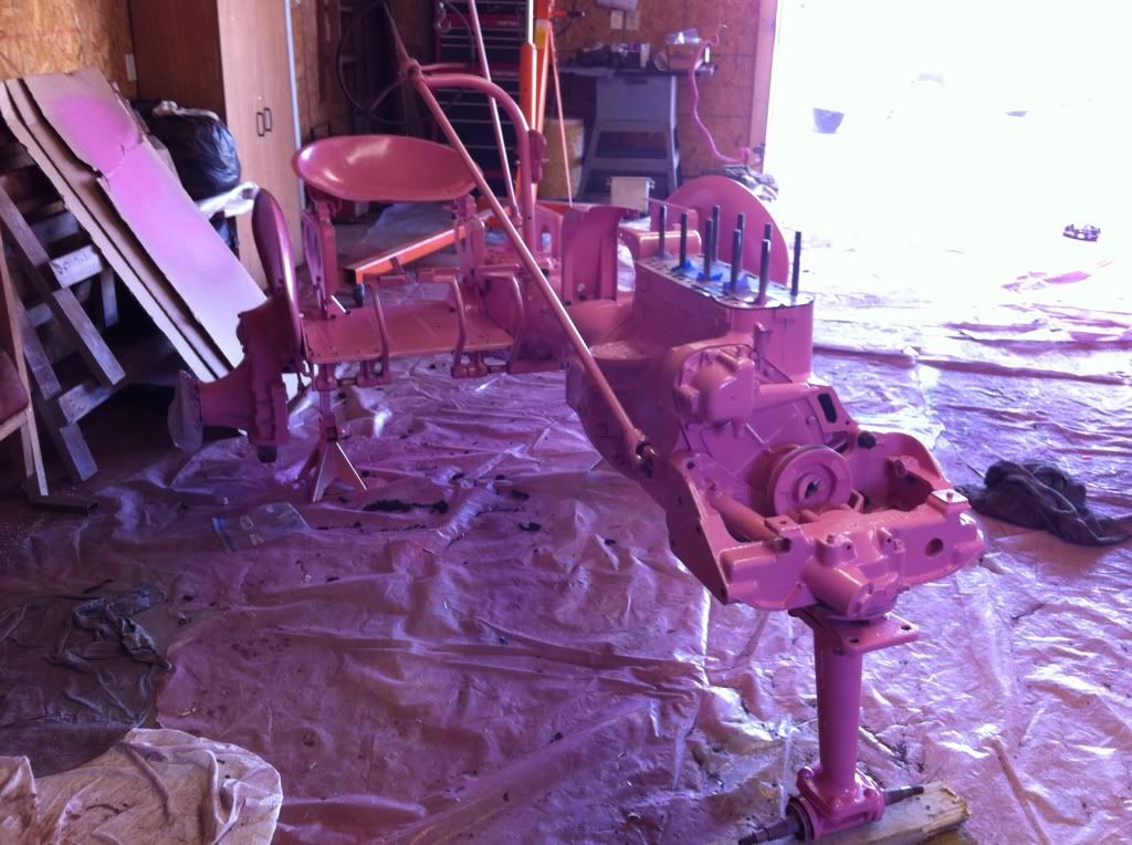

Started in in the main tractor color tonight got alot of paint to get sprayed in a short time. Here is the sheet metal and Chassie color

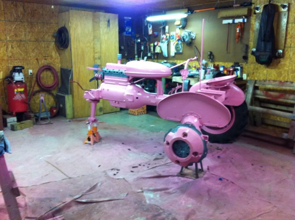

today was a good day, i got all the large parts with atleast one coat of paint on it. gonna let it dry over night and spray it again tomorrow. will be putting that parts all back on come tuesday and wednesday. Then to roll it out and get a good look at the paint. and finish up all the grey parts on the paint. before final install of everything. i still got a few parts to buy like the alternator and spark plugs and oil filter. but when you get down to talking about getting the oil and filters you are getting to the end of a long build. so here is where it came from for those who missed it before the crash .

has made one. i have only used the tank and grill along with the radiator and a few seat and floor board components off the second one th complete the first one. i also had to buy a block from a salvage yard that came off a 47'. so here is where she sits as of this evening

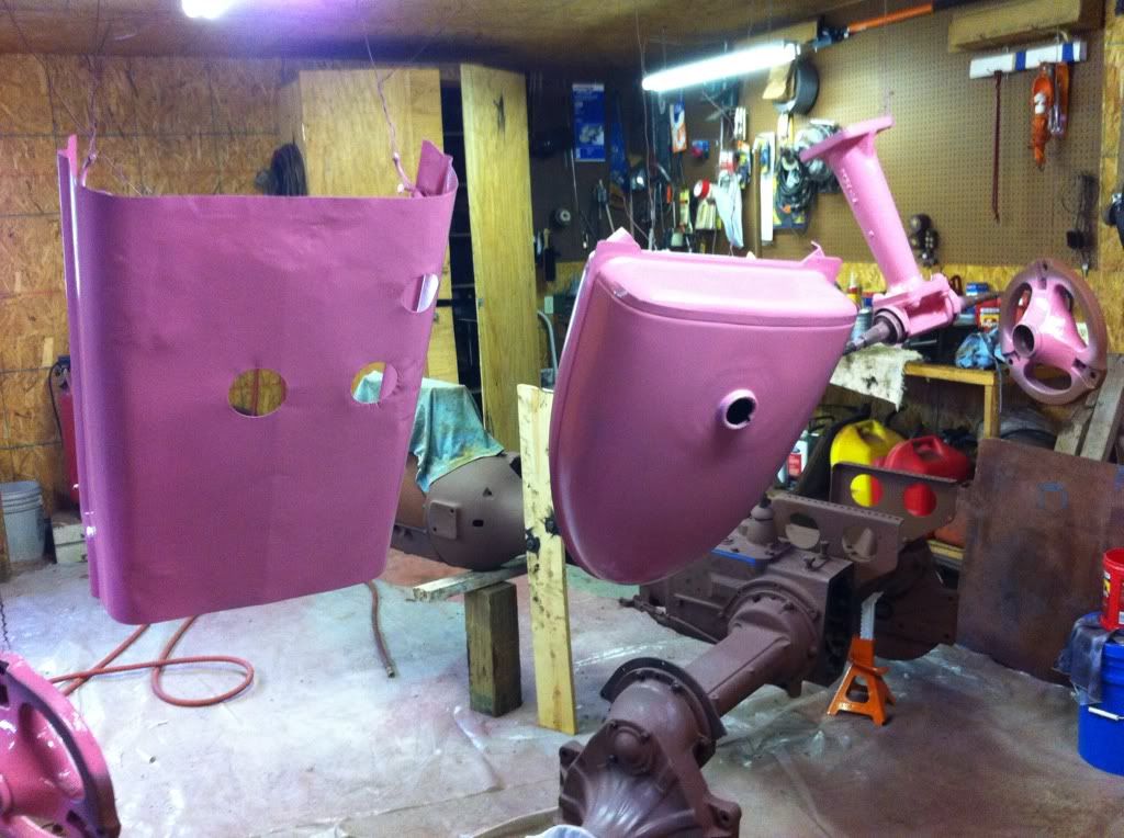

I didn't even realize how PINK it was going to be till i had it all sprayed today. i am going to wear sunglasses to spray the rest it is so bright in there
7

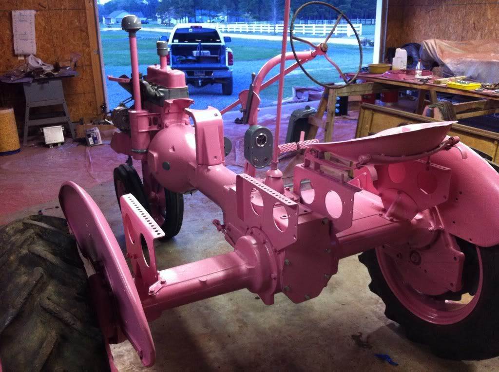

Your eyes aren't playing trick it is a five feet long, the original was broke so I had my dad machine the stub that was left and put a 5/8 brass rod threaded for a shifter. I will cut it to heighth when I figure out what that is. Here are the progress for today, got all the pink painted and will be done with the grey tomorrow. Getting my tires put on the rims tomorrow and picking up an alternator and wire and other wiring stuff.
I will be putting most of the parts back on tomorrow and finishing up paint . Ready to get this thing fired up .

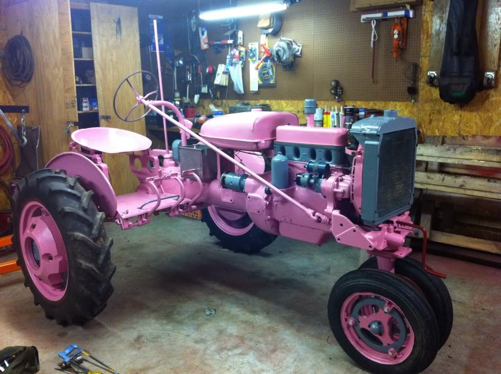

Today's progress .

I got her up on her runners today and started the reassembly of all the scattered parts. I quit when I twisted off a manifold stud. Guess I didn't know my own strength. I work the next three days so I may get a little in. I had my dad make the delete plate on the transmission. And my custom gear shift. How do you like the wheel color scheme.

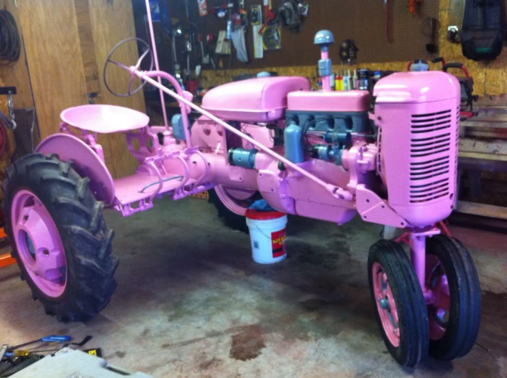

She been fighting me tooth and nail the past few days, guess she don't want me to finish her and start a new project. The bolt stud for the manifold still won't come out gotta get a carbide bit because I broke another bit off in the stud trying to make a spot for the tap. I did get all the wiring harness done thanks again John very easy instructions to follow. I got the distributor timed per the it manual and put plugs and plugs wires on. Mounted the radiator and filled it up check for leaks by opening the drain for the oil pan to make sure the sleeves are seated for now, then filled the transmission with fluid and crank case after reinstalling drain plug. Still gotta fill the final drives. Also made another discovery.... I restored a hood that dot even fit the B, so I gotta restore the hood that does. Just small but important things to go. Have a straight pipe, battery cables and battery left to purchase and that should be the end of this build.
