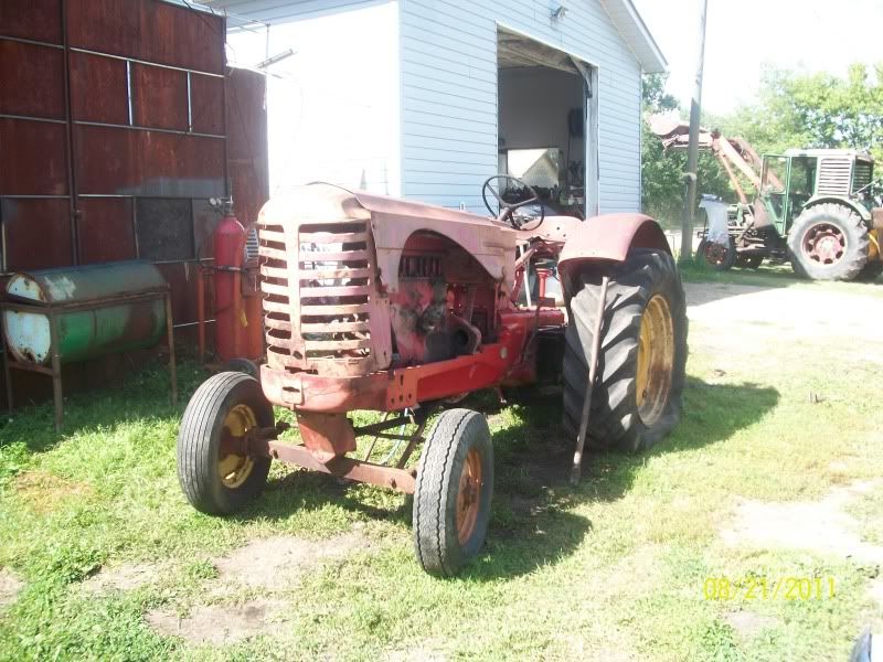

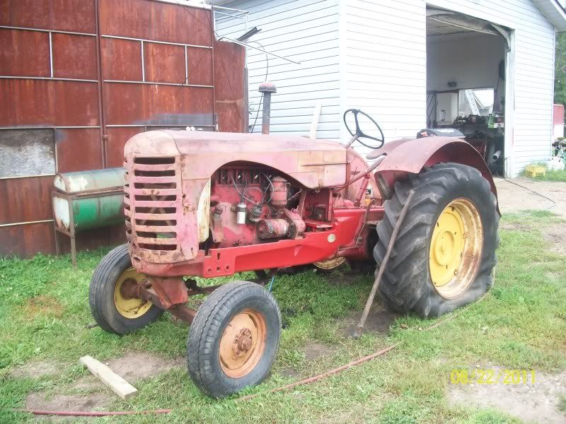

Just a couple of pictures I had from last summer. Want to get it completely together and run it in the tractor show in the first part of June. Then it heads for the overhaul shop.

Got it mobile this weekend. 1st and reverse work good.Just have to put back tires on it that hold air and install brakes. I am pretty sure it will make it to the local tractor show here this year.
