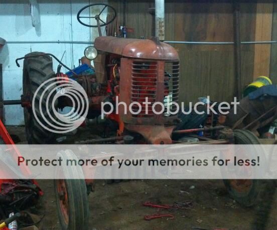

Back in 2009 I rescued this forgotten 1950 CASE VAC. Got it home only to find the block and head cracked under all the caked on grease. So I took it apart to assess the damage and there it's sat since. Saturday after supper I went out to my shop to pickup tools and organize a few things. 8 hours later my tools weren't picked up but a tractor appeared out of thin air! I have 7 VA series and all but 1 are in my shop torn down for various repairs. This VAC I picked to join my 400 diesel to be rebuilt into a working tractor, that is with all the handy and user friendly options such as wide fronts and remote hydraulics. Here is a before and the picture from 2:30 Sunday morning! This tractor spent it's life cultivating corn. I have the cultivators and fenders, but I don't know if I'll cultivate with it anymore. It's getting pushed into hay raking, back blade, post hole digger and other chores.
It surly did transform! These are near and dear as it was the first tractor I ever drove on the farm.
