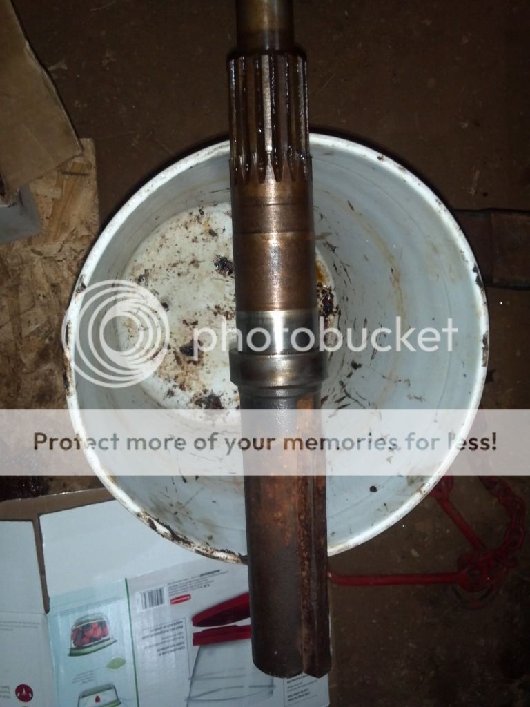

I bought this tractor from a friend 4 years ago now and had it shipped to me in a crate. He kept the engine, rear wheels and tin as that was all junk and he lives in North Carolina, which is a long haul from Wisconsin. I put it in the corner of my shop pending a full rebuild and restore, but having a baby girl the fall before and having tons of other things to do it got pushed off. Well, a month ago I decided now was the time since the JICCA summer convention is so close to home might as well put it together and bring it! Tractor spent it's life getting pounded to death on a tobacco farm and eventually left to die in the weeds. Every bearing in the tractor was junk but luckily most of the shafts and castings are in good shape. When I pulled the RH drop housing apart, the upper axle roller bearings scattered on the shop floor. The lower axle bearings are pitted, grooved, and broken. Here's the pictures of the beginning of it. Transmission needed a new reverse idler, oil slinger, and second gear. All seals and bearings replaced. Then, both drop housings gutted and waiting on a pair of bearing races my parts guy (have to cut his pay :oops: ) forgot to order! More to come as work progresses.
