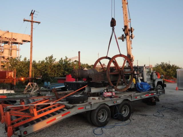

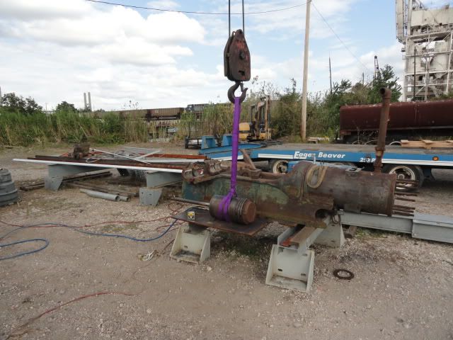

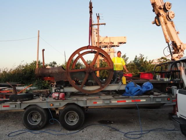

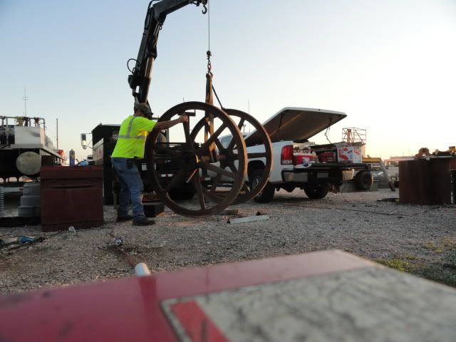

I bought this oilfield engine a couple years back, it was rusty, stuck, and missing it's flywheels. I was fortuanate to find a set of flywheels still on the crank, sad part was the crank was really to badly rusted, and pitted to use so I had to switch them over to the original crank. Heres some pics over a course of a couple years up till today when I set the crank / wheels back in the bedplate.
I had to drill the keys to get them to move and drive out.

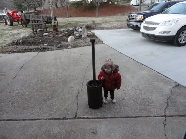

Getting ready to reinstall the piston
Our Grandaughter Stormie and the bessemer piston

The engine on it's original wooden timbers ready for shipping weighed 5300 lbs, that's according to what I have learned from an engine site. The flywheels are 1000 lbs, the rigging equipment is part of my everyday work tools, I have the engine here in Mobile, Al. right now so I can work on it of the evenings.
