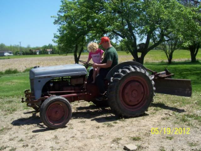

Well here is the beauty the girls fell so in love with! 2N with a Ford back blade...decent rear tires and good hydraulics. Elise can already run it herself :D So proud
6
Do I see a shifter knob on the left side of the transmission case? Got a sherman in her? :cool:
Great eye Ernie! Yep I forgot to mention the Sherman....this thing goes almost 20mph in high! :lol:

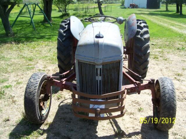

The loose steering,judging from the bent radius rod, might be a worn center axle pin.

How hard is it going to be to unbend that radius rod?
soundguy said:
depends.. lets see a better pic
I dont have a better pic right now, i'll get some more next time were up by the house. Thanks
these are the best i could find
You can take them off and straight in a press or leave them on and with a couple pieces of chain and some angle iron and a bottle jack you can straighten them right in place.

yep.. beat me to it.. but I've done the same. bottle jack and chain, and board or angle iron as a stiffener to spread the force and you usually straighten them right up. hint.. when bending.. go just bast center as when you take force off it will relaxe and bend back a little.
