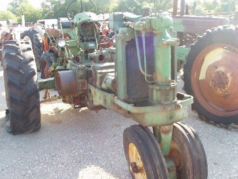

1959 model. 730D electric start I have all the parts they were being stored inside. sheet metal is fair
Question 1: I noticed it has hook ups for 2 batterys. tractor data says it is a 24 volt system but also says it took 4 6v batterys. What do i need to put on it?
