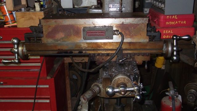

He'd picked up this HUGE non-working electromagnet at a flea market for a dollar or two and decided to make it useful. To clarify, it is sitting on top of the mini-mill table and is clamped on each end with the slotted clamps and weighs in at approximately 75 pounds. To make it work instead of a simple on and off switch, he decided varying the amount of pull would be desireable so....
This is the other end clamped in position with the magnet perfectly square to the mill table.

With the top raised, you can see the auto-transformer, which is essentially a huge variable resistance marked on the front with a dial from 0 -100%. Also there is the receptacle and switch.

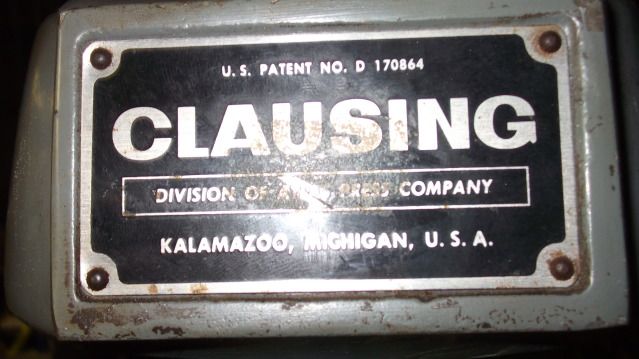

The machine looks as though it was made for the use of the magnet as it is nearly an absolute perfect fit. That itself is quite odd, because I only picked up this mini-mill about two months ago, acquiring it about 4 years after the magnet. I'm calling it "mini" because it only has a #1 Morse taper and maximum tooling is only 1/2" without reduced shanks on the tools or an adapter from #1 to #2. It still has a 30" bed vs a regular Bridgeport that typically has a 42" bed.

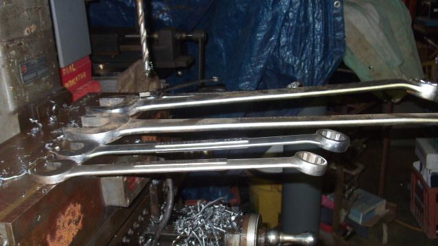

It sure has some grip, to illustrate, the bigger wrench towards the rear is a 1 5/16 and is being held on with just an inch or so of the magnet. Sitting a flat plate on the surface, you can't move it with a prybar. Talk about one handy-dandy addition to the tool crib....this is it. I seldom clamp anything for drilling at all, sliding the surface off the edge so the bit misses the magnet and that's it. Hit the switch, twist the dial to 50%, 60%, 70% and occasionally 100% and drill. Do the same with the end mills to slot or what ever, seldom having to resort to the old clamping methods.
