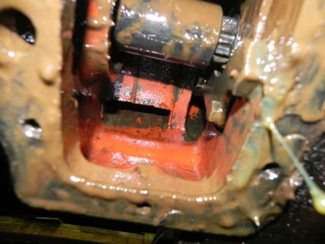

Draining the Oil from the hydraulic unit. Had the consistency of a chocolate milkshake, and looked like sausage gravy that you put over biscuits.

Wow nasty looking oil. Last time I drained some like that. Was from my John Deere LA I restored years ago. Ended up costing me big time on the differential and transmission. Had to replace every darn bearing and race in it.
I need to update this thread... just not tonight. All new bearings and bushings are going in it. Just the bearings alone are $815 and those aren't case. Case wanted 133/piece for each of the axle bearings and there's four of them. NSK don't say IH on them, but they're good bearings and I'm sure I"ll never wear them out as much as this thing will see use.

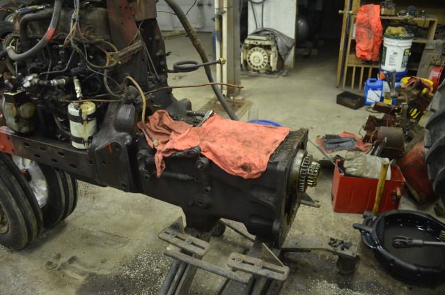

Time to split it and start disassembling the tranny
Pulling the gear train I sliced my finger open on the gears

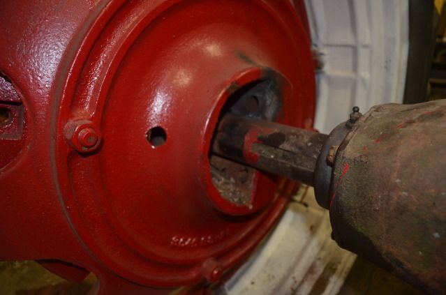

How the Heck am I going to get this nut off? It's 2 1/4" by the way. 3/4" airgun and the only socket I could get to go on it was the 2 1/2 since the nut was so beat up, took it right off

There was a pretty good gap between the end cap and the axle

Its kind of hard to tell from here. Looks like theres been some brazing soldering done to hold the nut in place. If so that will have to be removed. The initial damage to the stay nut was done more than likely by someone previously using a hammer and chisel to remove the nut. Thats easy to tell from the gouge marks on the nut. Its not a good place to have to do this; but Your option may wind up being to file or grind off the rough areas along the side of the nut; getting the high points off in order to use the right socket to remove it. The nut needs to be brought back close to original before trying to remove as this could well be one of the exceedingly hard to find parts.
On the nut, I work at a machine shop and I was honestly just going to mill out a new hex, drill it out, and tap a new hole. The threads are not sharp at all on the old nut and was either over tightened or something in the past because the high point of the threads are pretty much non-existant. I have big enough sockets for on the air gun, so I can put it on without having to use the chisel and a hammer plus I wouldn't have to cut the grooves into the sides for a chisel. I think the nut is supposed to be 2 1/4, but because the corners were busted up so bad, I could only get a 2 3/8 on it, and I had to use the air grinder and a hammer to get the socket to go on. It spun right off.

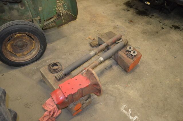

Axles pulled and one housing cleaned up

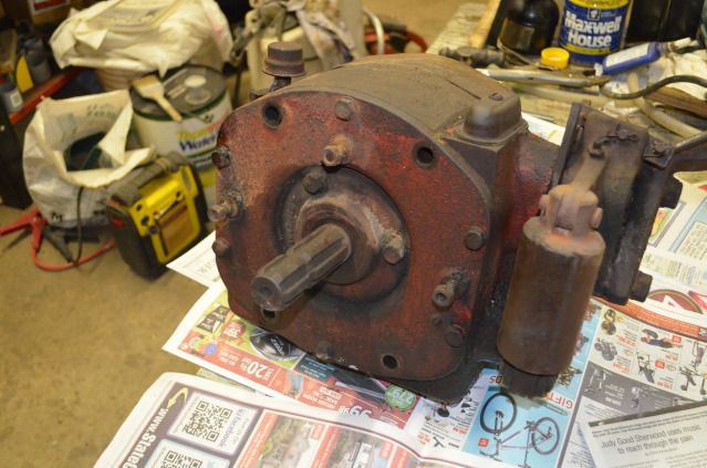

Just got done tearing the PTO unit apart. After I get this back together, it's just a matter of assembly of the whole thing.
Appearantly I didn't get a picture of the bare casting, but that's what its down to now. There really aren't a lot of parts to it.
17
I have all but two of the PTO bearings. Seals are on their way. The only thing I need to order yet is bushings for the tranny. Every new bearing, seal, gasket, and O-ring in the tranny and PTO will be new. All worn parts are being replaced or fixed up so they're not loose anymore. Mass assembly soon to come just as soon as I get all my parts
