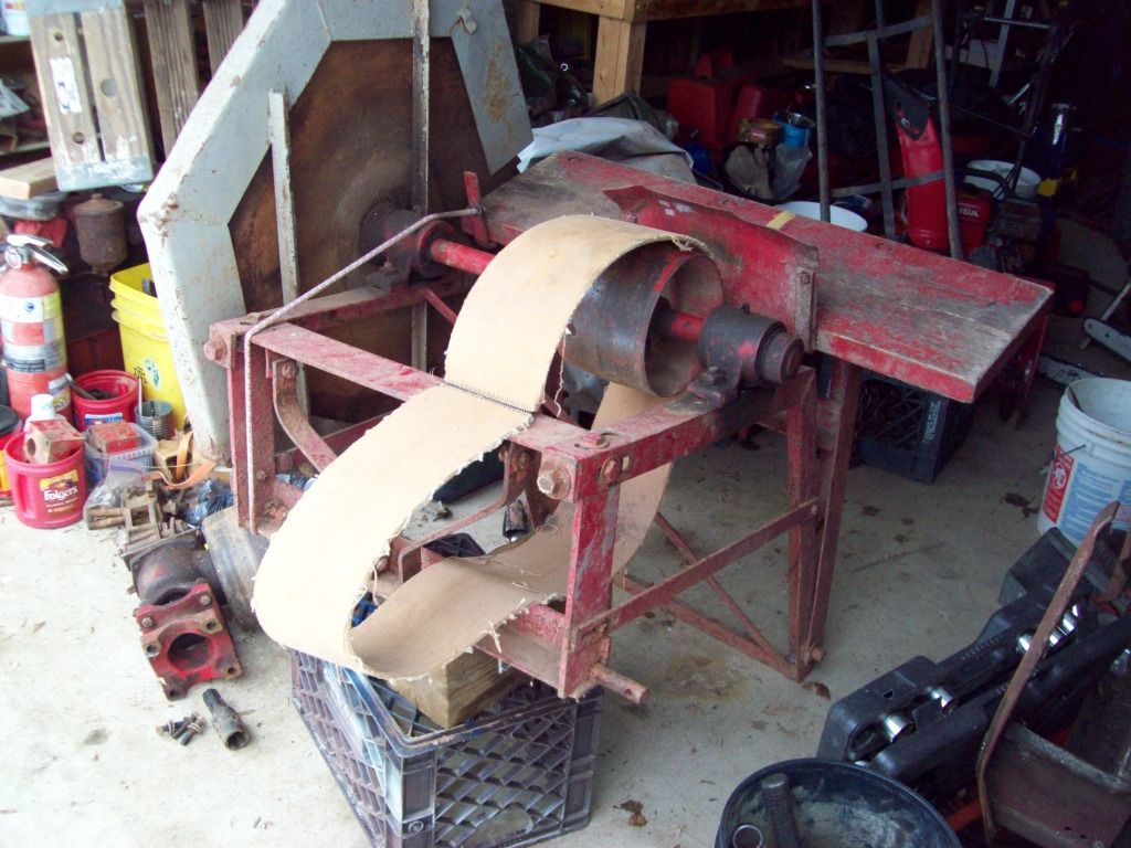

Picked up a cordwood saw yesterday. This one is in petty good shape. It came with the belt pulley, extention, adapter(1 1/8" to 1 3/8"), saw blade, belt, top link bracket that mounts on the pulley (most are MIA) and he even thru in a cover, even though it was barn kept. He had it mounted on an international so I'm sure I will have to make some ajustments. Mostly used for bucking fence posts around their farm. Since the storm I got plenty of down firewood to cut. I've be wanting a buzz saw since I used my friends dearborn saw but most of the ones I have seen have been sitting outside for the last 30 year,missing pieces and the owner's think they have gold. I'll post some photos of it maybe today. Snow's on the way so I might be plowing.

Here are a couple of photos of the saw.

Solid looking buzz rig! Nice find on this 3 point belt drive unit.
As mentioned I like the fact that they are easier on the back.
That set up is a lot more substantial than the lighter made Dearborn saws. Your bearings are nice and heavy duty Kirk. It looks like the right angle drive has a cast extension to allow for the length of the 1 1/8 x 1 3/8 adaptor, or are my eyes deceiving me? My M-H-F right angle drive fits the back of the Fords but you have to use the thin 1 1/8 x 1 3/8 bushing, which cracks the first time you use the saw. I shot grease in to hold the broken pieces in place and it works fine.
Good deal on the rig...you will love the tilt top. Does that bolt with the T-bushing near the pivot have springs on it or are they missing ? If missing a couple valve springs will work to push the table back at you from the bottom of travel, but too many or too stiff of springs and it'll make you grunt to compress them to saw.
Bearing are in good shape, no slope or play, nice and smooth. Yes it has the adaptor for the 1 3/8". We used the thin one on the 8n beater we use at the deer camp with a bushhog and ORC. It broke the first time out. It was a quick fix, just changed out the ORC to the proper size. Would buy the thin one again.
There is a spring on the pivot but only on the one side. After checking the manual they also have it on the one side. I may change out the spring anyway so I may add one to the other side as well.

I haven't decided which trator I'm going to put it on yet. But what's nice about this unit is when you raise the 3pt up the hole thing goes up and slacks the belt then when you set it back down it tightens the belt again so you don't have to fool with it.

Got the saw hooked up. Still have want to change out some bolts and make some adjustedments before start up.

Kirk, I'm having trouble seeing how the top link bracket hooks up and what it hooks up to. Can I ask for another shot showing that detail a little more clearly? That will help me decide what to do with one of the Dearborns I've still got in original condition. Thank you, sir. That thing looks like it belongs on the back of yours !!!
