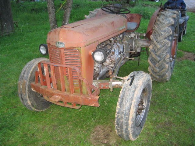

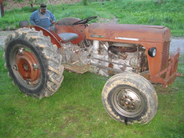

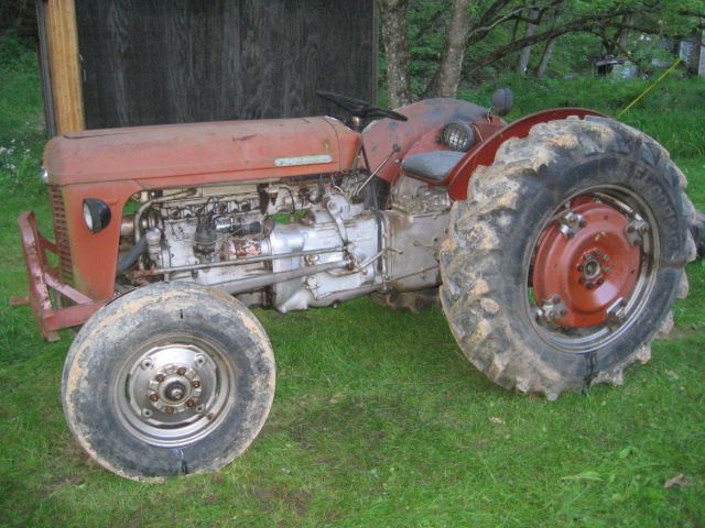

Me and my cousin kinda went in on this one together! Thought we would tinker with it. For the price we paid, it was worth it. From what we were told at first the engine had been overhauled, but shortly after it lost oil pressure, and was knocking! To make a long story short we had it running and was driving it around today!!!!! For whatever reason someone had dumped at least a gallon of gasoline in the crankcase(which was causing the no oil pressure), and #2 and #3 plug wires were crossed. After we got the points dressed, it started right up, and carries nearly 50 oil pressure. Engine makes no noise whatsoever. Runs like a top. The tractor has new tires all around. Sheet metal is perfect!!!
Its a 55 year model, and a deluxe model, it has 2 stage clutch!

Nice looking 35 what motor does it have,can not see an exhaust pipe,did one up myself two years ago they are a nice little
tractor that one you have got will go for years now,thanks for the photos.

It has the Z134 continental, exhaust manifold is broken!
