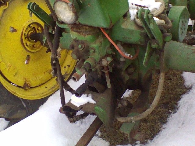

I have a 1948 john deere B with what looks like most of the components of a 2pt hitch. I am trying to attach a no.5 sickle but I don't know if I have everything and I am unsure where the parts go. If someone has a tutorial or some pictures of the attachment attached please share.
I have about 5 no.5 and 2 no.8 sickle mowers with spare sections and a few boxes of new cutters. I would just pair them together but the tractor and sickles are far apart
here are pictures of the rear of the 48'

I can tell ya after looking closer at the back of your tractor you have the right parts on it, if your #5 mower has the quik- tatch feature on it!
