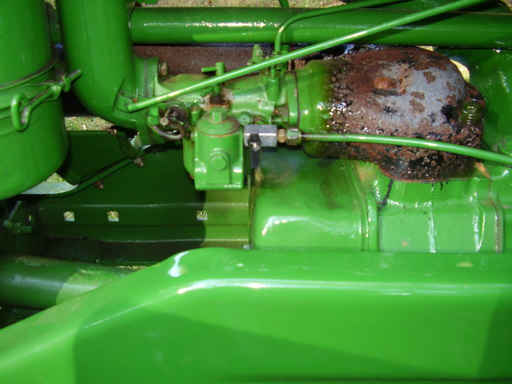

Here is the one non-factory fuel system modification that I highly recommend, putting a 1/4 turn shutoff valve inline before the carb;
