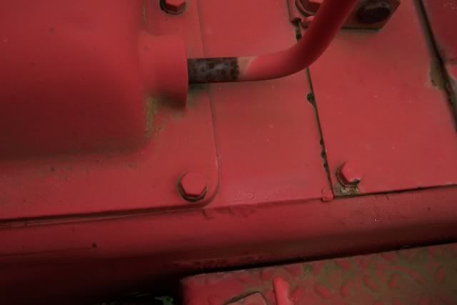

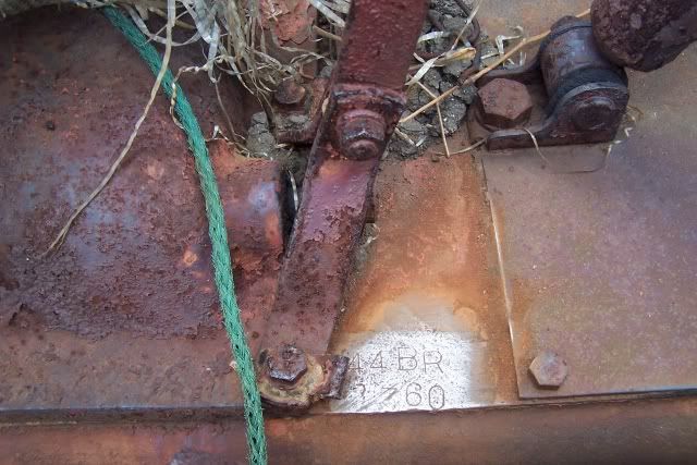

This is how it looks on a 81,20, 22, 21 (colt) and 23 (mustang)
On models with a PTO the oval plate will have a switch lever.
Here is where it is at on the 101r's, 101 Seniors and 101 Juniors. sitting on the seat it is just to the left of the PTO lever.
This is where it is on the 30, 33, 44, 333, and 444 Sitting on the seat it is just to the left of the PTO input lever. On the 333 and 444 sheet metal may have to be moved. My 44 br# b is for butane r is for rowcrop.
