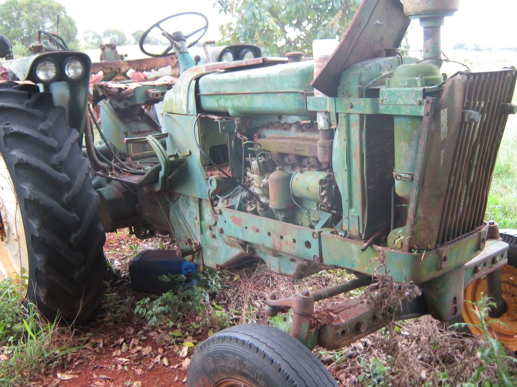

We have just got a 2010 JD has been sitting in a padock for 17 years i'am looking for 2 turbulance chambers can you still buy them I would like to get it runing again :)
I puled the other 2 out

Hi the 2010 is missing two injection chambers any idea where i can get some in Australia or USA Thanks John :)
Click on the blue (John deere parts books) above. it's a link that will take you to their site.
Type in your model number 2010 Once you find the manual for your machine, Open sectional list , then fuel and air, #54 and 55 are turbulence chamber pages.
There are several part numbers listed for the 2010 turbulence chamber by serial number breaks. AT16746, T18533, T11222, T18841
Find the one for your tractor and take it to a Deere dealer, Should be able to get what you need.
