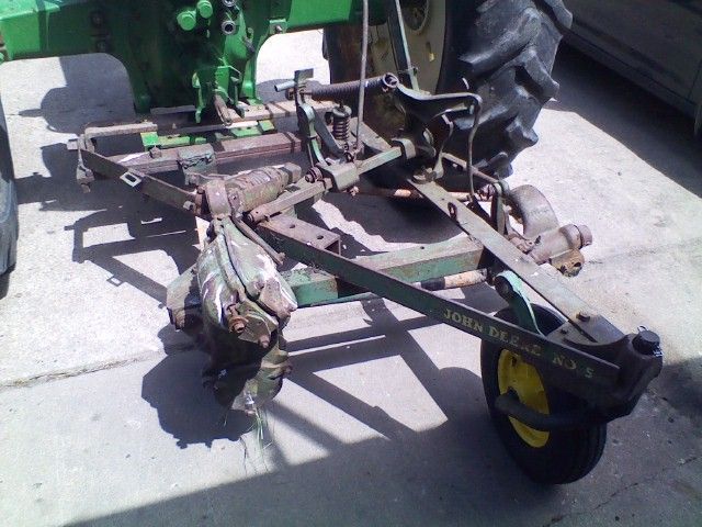

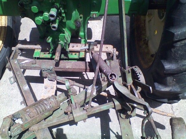

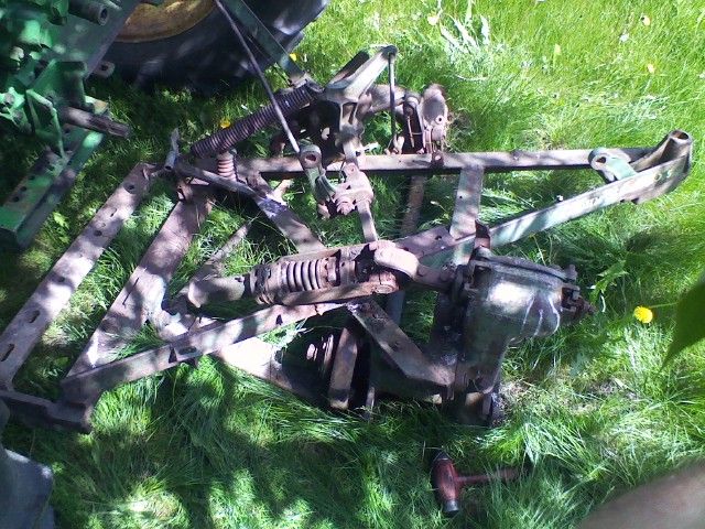

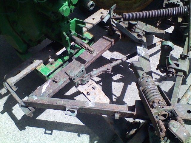

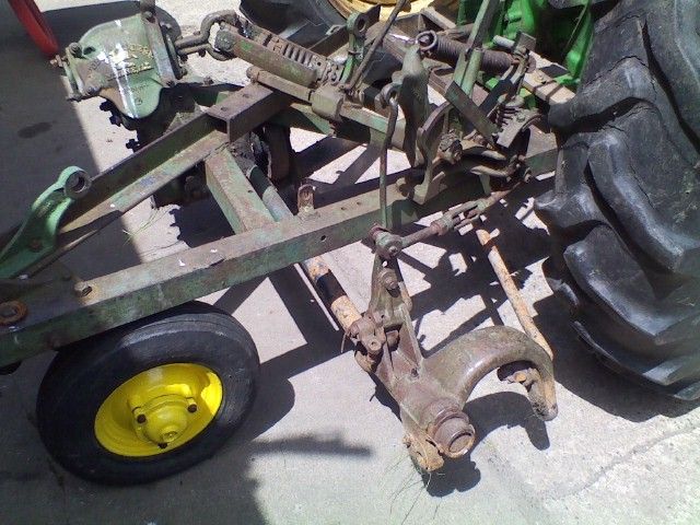

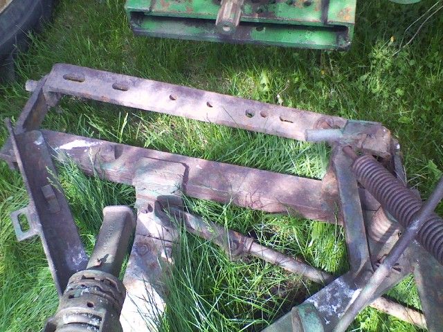

I have this john deere no. 5 sickle that has been welded numerous times and has a bolt on bracket that seems to fit my Model A however there is not enough room to install a PTO shaft or raise the mower bar vertical.
Can someone help me identify what the mounting bracket was designed for? it fits my A but no room to make it work.
341 Posts
You are missing the mounting brackets. They hang behind and under the drawbar frame. Go to Deere's website and look at the parts book. The brakets are bent angle iron. It will move the mower back far enough for you to hook up the PTO and lift it.
