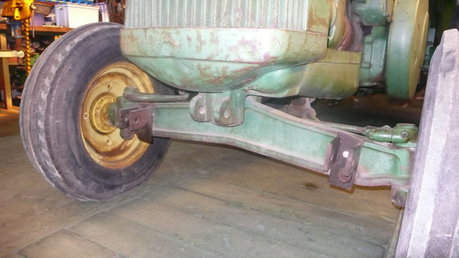

The front axle ...
29

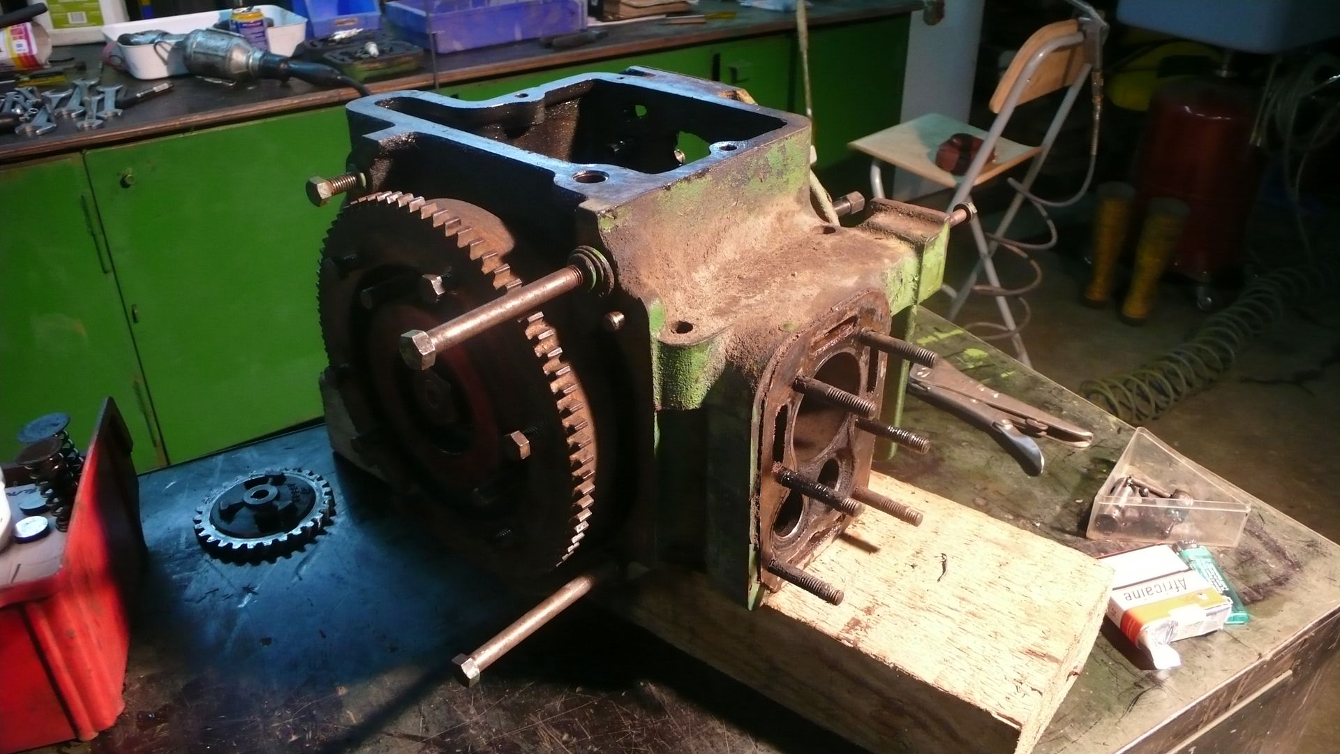

Let's slaughter the pony motor ...
As you can see is a lot of work ahead of us.
The valves, the piston rings, main bearings, all gaskets and bother bearings must be replaced by new ones !
The crankshaft also need an therapy !!!! :shock:
next time more about this ...
18

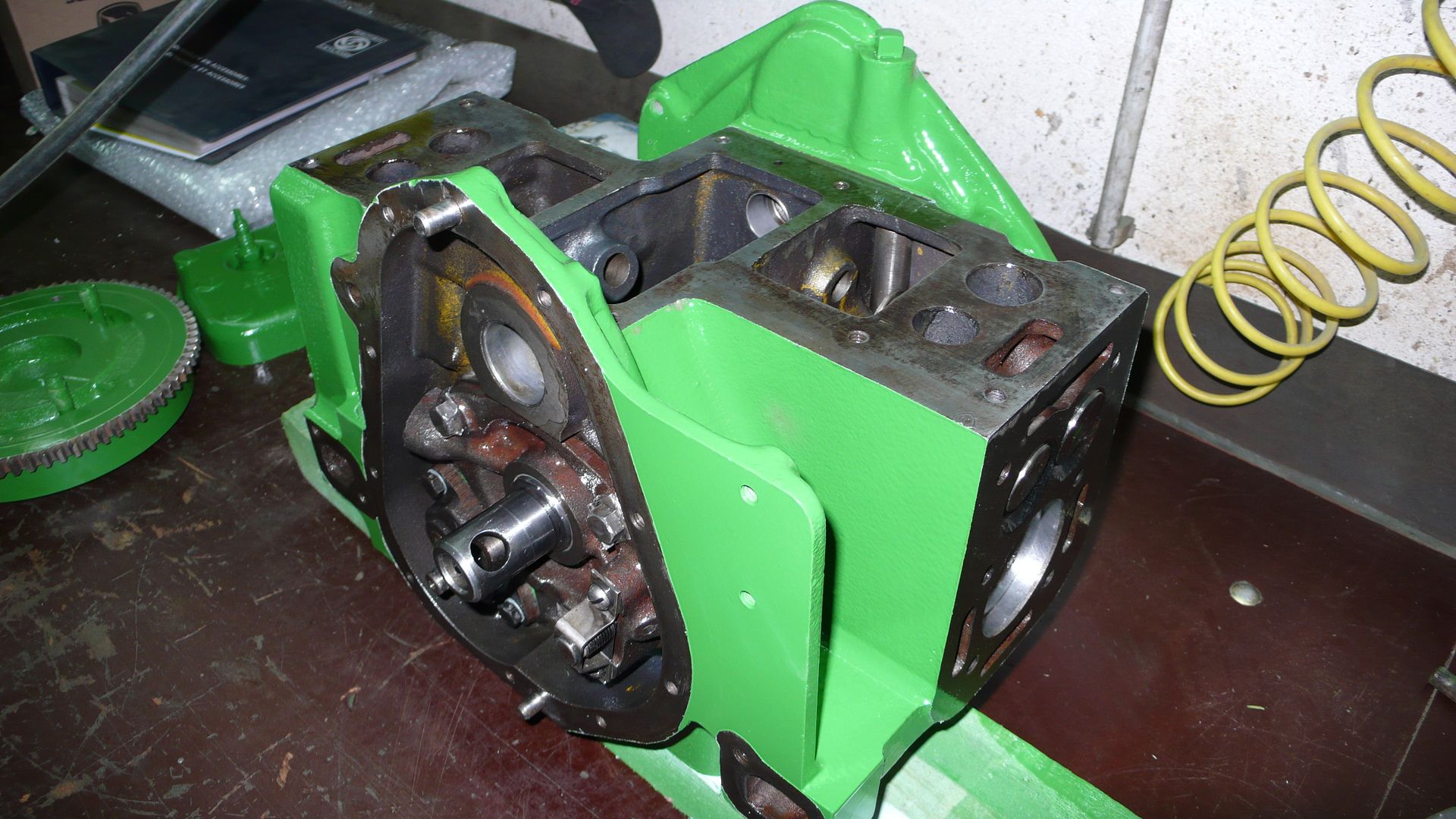

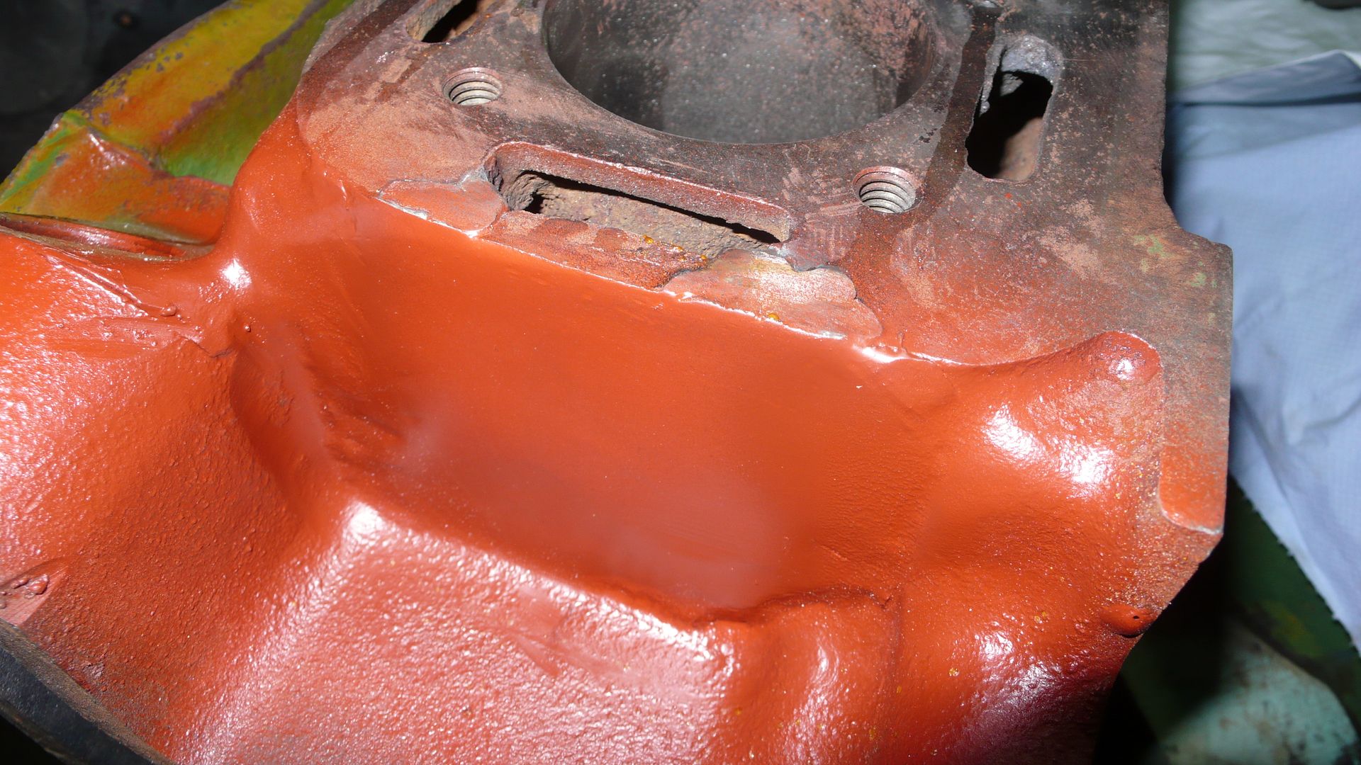

Hello everyone,
The work on the small engine continues ...
After being welded again ..
After this, the engine has received new valves, piston rings, the cylinder has been hoon, and the crankshaft has been worked, the block and the heads has been grinded ...
Look on the top of the block before reinstalling the manifold (engine cover)
A picture to show the difference between the valves from the diesel engine and the pony motor ... :cool:
After sandblasting and the primary color..
11

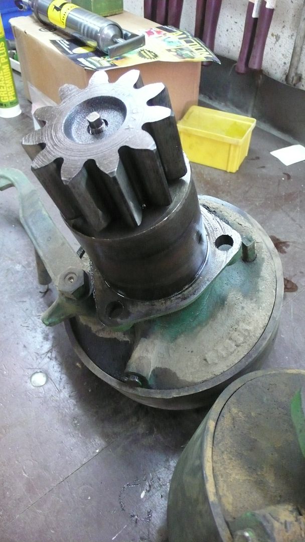

Today the starting engine transmission.
After being retired from the pony motor...
After cleaning cleaning with hot water...
After desassembling the transmission ...
Ready for sandblasting ...
9

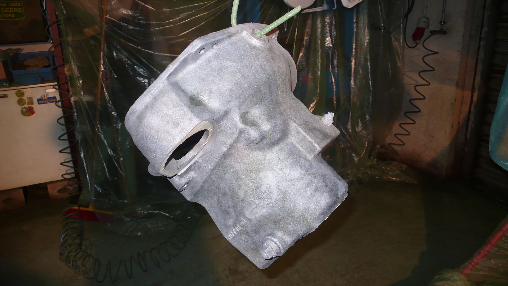

Hello,
Lets finish the little transmission.
After sandblasting the parts...
... priming and coloring.
The parts of the transmission. (Bushings, bearings and gaskets has been replaced by new ones)
12
