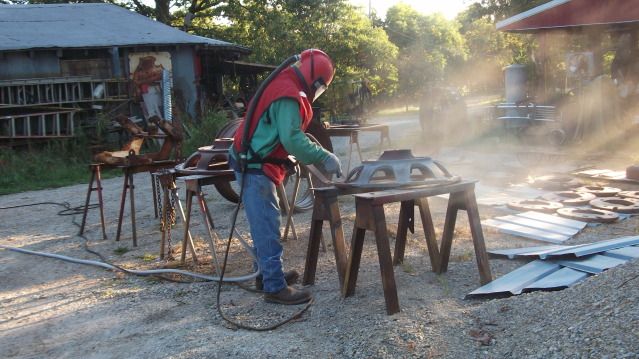

Hooked up and ready to go, gotta get him into my blast helmet and I gotta get my earplugs...
A shot from the rear of my scrap-built sandblaster....there's a post with pictures and the story somewhere in "I need to tell you all" if you are interested.
Time to get started, we have all four rims, rear rim centers, all the sheetmetal, drawbar, Saginaw 3 point assembly, four sets of wheel weights and well... just about anything that couldn't be dipped in the electrylosis barrel to blast.
Moving right along, my duty is just monitoring the engine temp, oil pressure and moving freshly blasted parts out of the way, moving rusty parts up closer and monitoring the belt tension and pressure on the blaster. The tank holds just around 800 pound of silica sand and will run full blast for 2 1/2 hours between refills. I mistakenly said on the other post it held 600 lbs. :oops: :oops:
A few of the parts laying in waiting...we can vary the pressure for thin sheet metal to prevent warpage, but there was no issue with it at all this time.
Some ready for primer....
Nearing the end, I think he's beginning to wilt a bit, because we ran out of the morning shade and its starting to toast up a bit inside the helmet... :lol: :lol: :lol: Boy, I'm liking this tooooooo much !! :lol: :lol: :lol: :D
Down to the end... all in all we used about 1600 pounds of sand and total time consumed with the blaster at full speed was less than 5 hours. Of course, we started around 7:00 a.m. and finished up around 1:30 p.m. but hey, we had to stop for lunch and sand tank refill.....plus you gotta remember we are just a couple of retired old worn out former members of the work force just hobbling around with our walking canes trying to find youngsters to do our work for us !!!! :lol: :lol: :lol: :lol: :lol:

Are you able to reclaim any of the sand?
No Mike, not at all. Sometimes when we do a small project and stretch out a huge tarp, we can recover some of the sand. The second use is about all you can get as it becomes powdered quite quickly and loses its abrasive quality. The more the powder, the more the dust... :cry: :cry:
