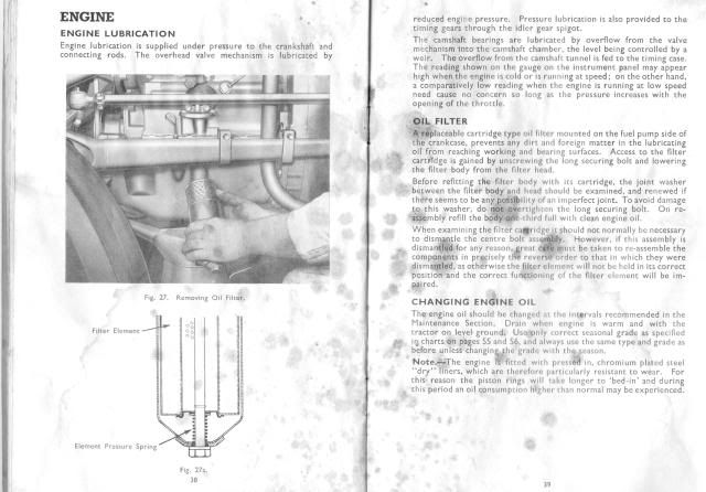

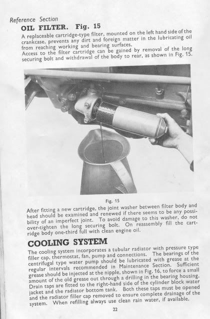

this is the Wrong tractror....TEF 20, wont delete post.
Les seems to think bottom side of canister, away from engine.
Ignore my post ...picked up the wrong book...... try the next one....sorry
Correct tractor MF35
Patience is a virtue they say ..if at first you dont succeed.........
