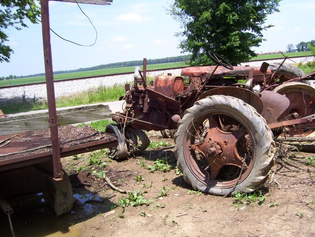

I'm hoping for a good crankshaft and distributor off this one
I would like to do a SC someday, This one has been in the woods no telling how long with no spark plugs in it. I wont give up without a fight but I don't have a lot of hope for this one either. If not I'll have some parts When i do find and SC

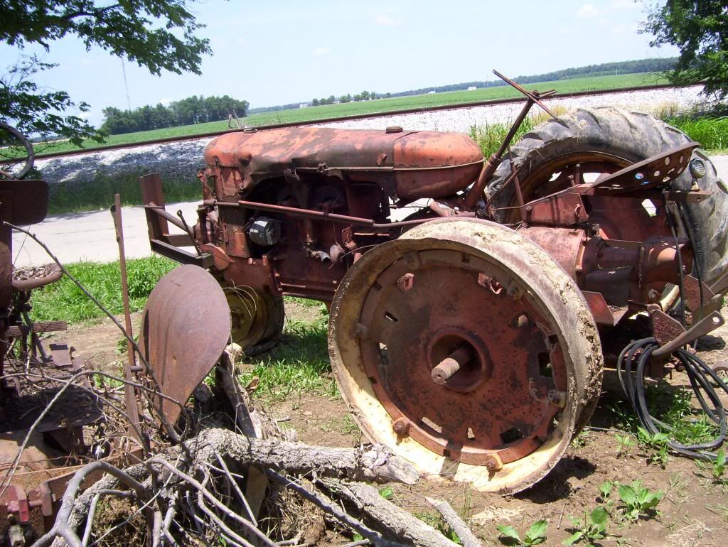

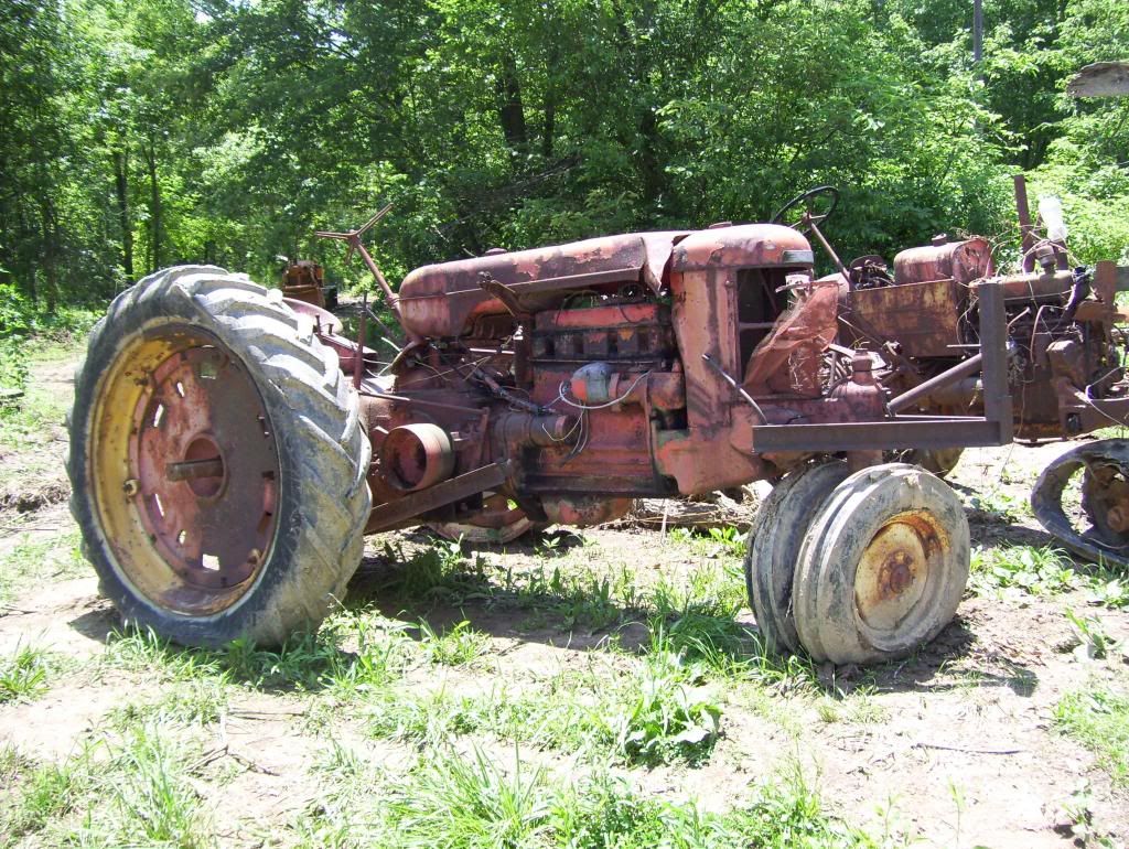

the VAC is parts, and not many at that
The SC I am going to try to get it freed up, we'll have to see.
341 Posts
According to my 1947 retail price list shipping weight on a SC with 11x38 6 ply rear tires is 3869#. The VAC with 9x32 tires was 2398#. I see the VAC has one 32" rim on the back. It might not be that hard to put it back together. There was a member on the old forum who bought a VAC in about the same shape but taken apart, and after an engine overhaul and some donor tractor parts it's a runner. The SC is an early one with the flat cast wheel centers. Nice haul either way!

That Vac looks like it has a lot of good parts to me. The SC you never know sometimes they suprise you and I hope that's the case. Just wondering do you still have the 2000 you were working on?
189 Posts
I have drug home worse looking tractors!!
I have found that a rough parts tractor will have at least one part on it that is better than the same part on a good tractor.

I want to thank 1031d for pointing out that that is a 32" tire. I went today for the last tractor a MM and asked him, we went behind the barn and found the mate to it. the rims are shot but both tires look good. If the rims are still available I may put them on one of my VAC's if not I may see what a used matched set is worth to finance some more parts.
