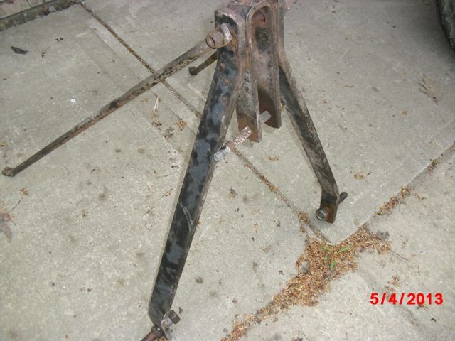

My friend Jim stopped and he seen what I was working on and said he had a extra three point hitch from a mower like this. Off I went to get it!
Here is the three point to be adapted to the disc.

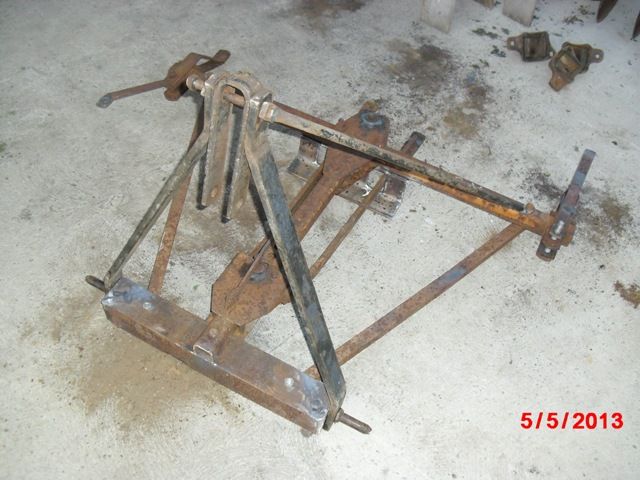

Mock up as it is coming together.
I fabricated the front cross member from some angle and turned the corner with the angle to allow the draw pins to be bolted through. Also added a angle bracket in the center to support the two sliding adjustment arms. This will allow the disc to be lifted and the center of the disc will be supported.
