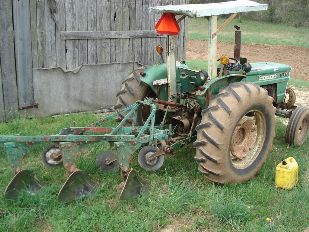

this 42 year old 1355 has over 10000 hours and the only thing that has been replaced is 1 clutch and a set of thrust washers in the front end,
it has been used hard but not abused, and that is the key to long life in any tractor, it pulls the 3x14s with ease and is very stingy on fuel
