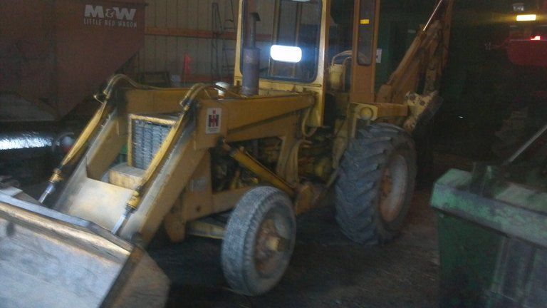

I'm scratching my head on this one. Working on a 3444 International backhoe. Last summer the engine started overheating shortly after starting it up. It'd go up to 220 or so, then drop like a rock to 140. It would do this 2 or 3 times then level out. I tightened the fan belt, (wasn't really loose but....) Changed the thermostat, 185 degree
(it was just changed 2 years ago. but ya never know), Then antifreeze started coming out of the muffler! OOPPPSSS! Bad headgasket. Changed the headgasket and had the head checked. Also had the radiator preofssionally cleaned, (bertman) Put on new hoses and fresh antifreeze. Changed oil, retimed the ignition (story in itself :roll: . don't ask) Even had carb rebuilt. I did everything I could think of and it still gets up to 215 then cools back down a couple times before it levels out at 185. It never used to do this. What am I missing? :? :? (don't have much hair left to pull out.

I think you guys helped me solve the problem. I ran it up to the main shop today to to try acouple of the ideas you guys had. Little did I know our hot water heater was set to 180 degrees! :shock: Not really, but the old temp guage said to was. HMMM Put the new guage in the tractor and it appears to be the problem. When it warms up and dries up alittle, I'll get it out and run her through her paces. Thanks guys for all your ideas. :D
