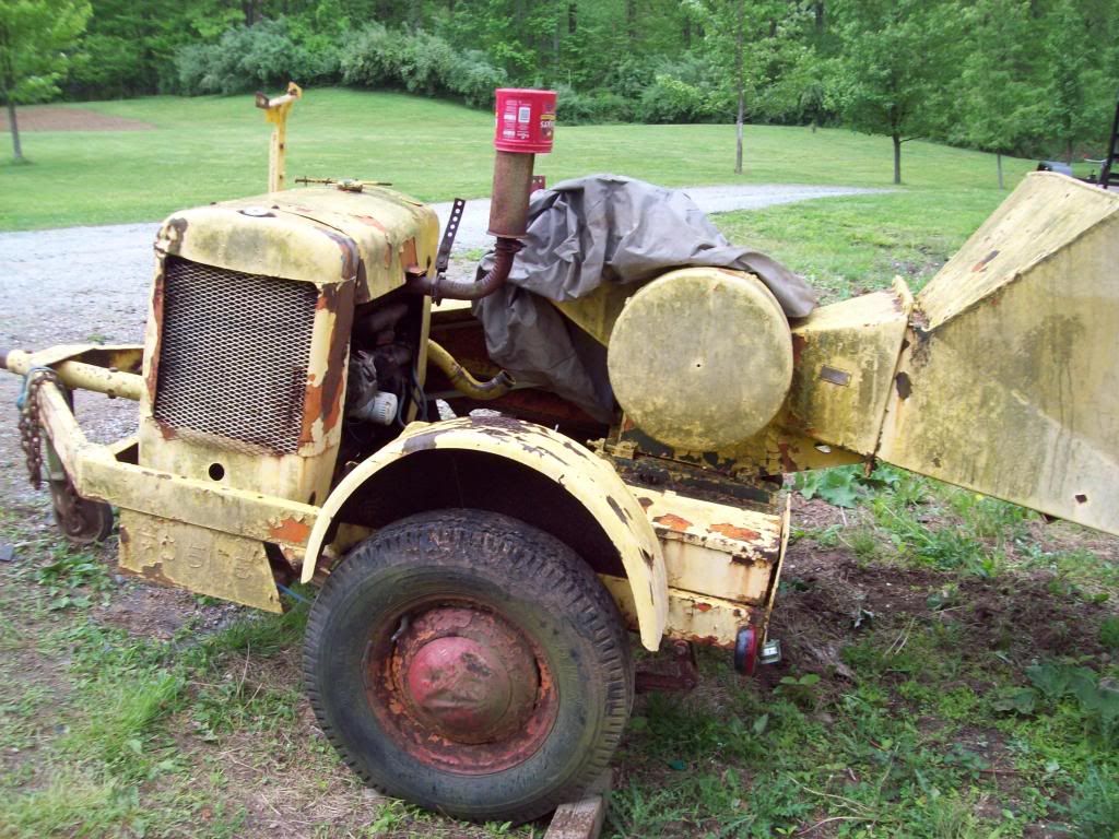

Since there is a "NO MORE TRACTORS" ban issued at my house I picked up this ford 172 motor that's attached to an old chuck & duck asplundh wood chipper. The engine is stuck. I picked it up for less than scrap so I can't really get hurt. Plenty of good parts on it. I was hoping in was a 192 so I could use it for pulling but no such luck.
Power units are definitely a good source of spare engines. I passed up a Ford powered generator last year that I shouldn't have. Motor good, generator bad. Couldn't tell for sure what motor it was and didn't know where to look.
Looks like you are doing a good job sticking to the 'no more tractors' order....good thinking.... :D :D
Nope, not a tractor..........Your'e safe :lol: :lol: I could sure use a large chipper as well as I'm sure you could too. With all the trees we cut down just through the chips back in the woods.
Nice find ;)

Tore the head off the 172 and the cylinders had water in them as a result of an up exhaust that had no clapper and was not covered. Have it soaking now. The block doesn't appear to be cracked but we will see once I get a chance to tear down the rest. A few of the rods were bent. I paid less than scrap price for it so I can't really get hurt on this one.
Kirk
2,499 Posts
someone may have tried to roll it over with water in the cyl and hydrolocked it.. or the exhaust that were open letting the water in rusted tight, thus popping the push rods.
i just redid the head on a 4000 4 cyl that made sphagetti art out of it's push rods. had to use acetone and atf fluid in a spray mix and soak it for a few days, then beat the valves out of the head with a dead blow hammer!!!! all the valves survived...
530 Posts
Discussion Starter · #13 ·
I suppose that's what probably happen someone tried to break it free and since those rods are the weak link they're the first to go. Heck I've even bent valve's in the flathead tring to unstick them so I know the deal and don't force it if it don't want to go.
