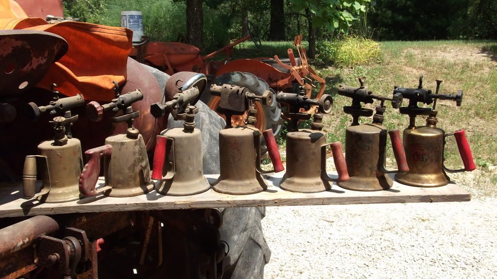

Very nice collection of irons. I have some soldering to do on a stainless maple syrup pan (candy machine pig) today. Maybe I will take a few shots and post them here. My collection of irons is limited to about three, but they work good for small soldering projects. Glad a friend taught me some of the basics in using these irons. I have used these skills a lot in keeping syrup pans leak free, and building items in stainless steel.
Nice line up of torches that you have too! I don't have any of those. I use Mapp or oxy acet for heating the irons.

nice irons.
them gasoline torches always kinda scared me.. :)

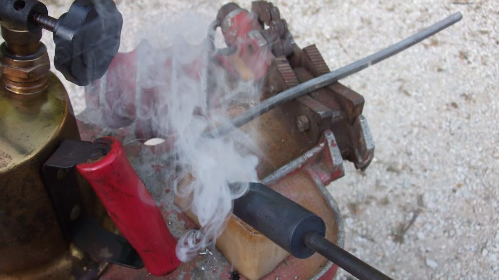

They're not too bad, once you heat up the nozzle by burning the little sump full of gas the gas is literally vaporized as it passes through the needle valve. ( SAFETY NOTE : Do not open the needle until the sump is very near all burned out or you will have an 8' stream of burning gas shooting across your shop !!!) All you gotta do after the torch is heated is open the needle valve, then when the flame velocity (or intensity) goes down, pump up the pressure again with a few rapid strokes of the hand pump and you are back in business.
The gas torches body itself never gets even warm. The cool thing with these is they heat the 4 sided irons very evenly, you just rotate the handle as it sits in the iron rest. Always use two at a time, that way while one is being used, the other is re heating and don't hesitate to re-tin the iron repeatedly while cleaning with the salimoniac block.
If you take your time, you can really do a good job and you can stack beads with practice. But if it ain't showing, I just blob it on and smooth it out and go with it.
I'm sure you guys knew how they worked, I don't know why I explained it.... :oops: :oops: :oops:
If you are unsure, use it a few times OUTSIDE and pointed AWAY from your shed. ;) ;) ;)
