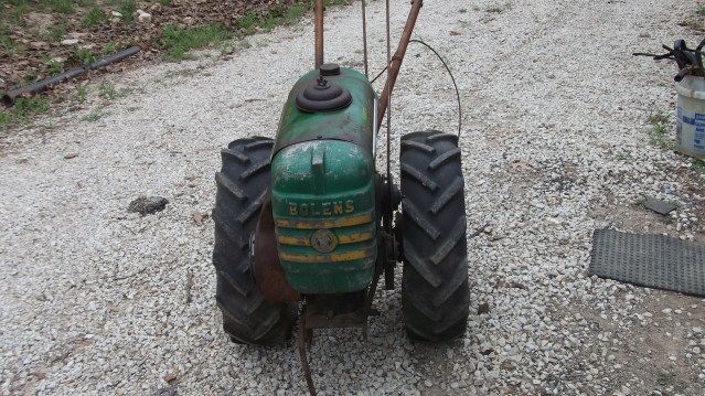

My SIL, Mike, stopped by an auction the other day and couldn't resist the impulse to grant me another gift in trade for me granting him permission to marry my oldest daughter 9 years, 7 months and 15 days ago....and HERE it is !!!! :D :D :D
Being married to my little girl necessitates a great deal of frugality on his part, so I KNOW he got it cheap. :shock: :shock:
I feel HONORED that he would spend $25.00 of his hard earned "rat-hole" money just to make his grouchy father-in-law happy....but I would never tell him so... :lol: :lol: :lol:
It'd been stored in a shed for a undetermined number of years, but it has definitely been a long time. No matter, I tinkered with the carb linkage with needlenose (note the broken throttle cable), dumped in a quart of liquid gold (gasoline), tapped on the carb a bit, sprayed a little wd-40 down the sparkplug hole and tugged the rope and she popped !!! AHA !!!!!
http://i1231.photobucket.com/albums/ee518/MissouriMasseyMan/Broken%20Kubota%20and%20Bolens%20Garden%20Tractor/BrokenKubota
Made sure there was oil in the crankcase and within 20 minutes, was chugging up the roadway to my SIL's house grinning from ear to ear.

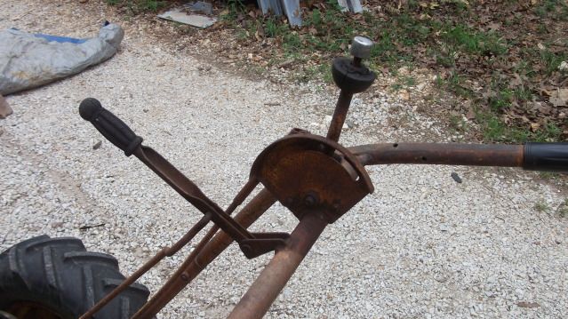

I just knew I recognized the control bar...went to another storage building and hanging right from the rafter is an identical control assembly with a perfect knob to replace this broken one. Further proof that you should NEVER under any circumstance THROW any thing away... :lol: :lol: :lol:

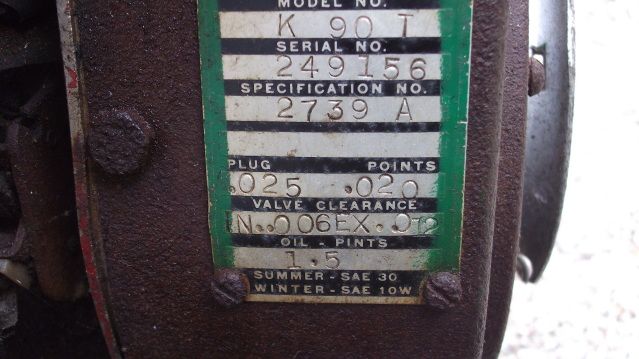

Little biddy old Kohler motor must be bullet proof to still run as smooth as it does....Anybody got a clue how old this is ??? Now if I can just keep my SIL
convinced about how much he still owes me for letting him into the family.... :D :D :D

I spent a lot of time walking behind one like that growing up. Finally built me a sulky to ride behind it when I had the cycle bar mower on front.
Mid 50s is the time frame for them, the one Dad had was a '55.
