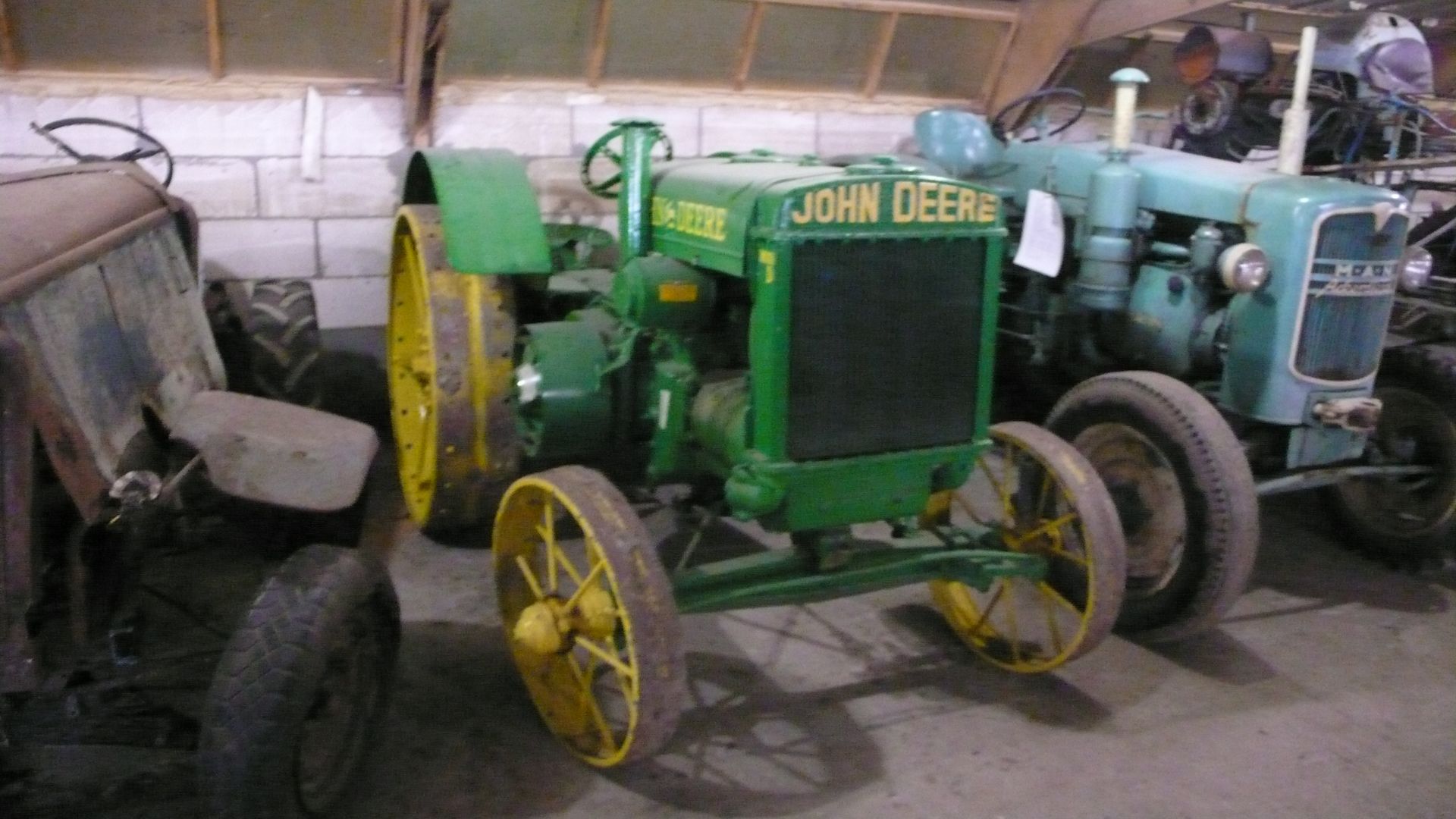

Let's restore a John Deere D (ser.#34441) :p
I bought the old deer at a Belgian classic tractor dealer and brought the tractor to Luxembourg.
Unfortunately, I don't know much about the history of this tractor.
I only know that he was in an auction in leola (2008)
I saw him in this state for the first time at the merchant (in Belgium)
If anyone of you has info's on this tractor (34441) I would be very happy to know them :!:
The tractor was offered as restored. But each of us knows that this is always dependent on the eyes of the owner.
Shortly you can follow the restoration here... ;)
(As usual with lots of pictures and surprises)

211 Posts
Hello,
Thanks !
It gives me pleasure to read that someone is interested in our restoration. :p
Here are some pictures from the transport of the old deer.
(No wonder, for the steering wheel side of the truck.
The truck came from the The Swiss Army, they have the steering wheel on the “wrong” side)
Unloading from the truck.
Unfortunately, the truck, (at this time) had no ramps, so he was transfer on our wagon.
And here the deer in our “Deer-clinic”... :lol:
At first sight everything looks good, but you'll see that appearances can be deceiving.
Soon more photos in detail... ;)

211 Posts
Hello,
Some details about the old deer.
You can get an idea of what work awaiting us. :eek:

Looks like the Deere has the steering wheel on the wrong side too. :?
What some people called restored most call freshened up, and he didn't
even paint the wooden plug, or screw or whatever it replaced. :|
Some things you just have to laugh at. Lots to do and not anything taken apart yet. ;)
