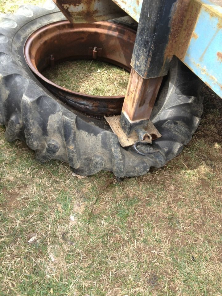

I had a rust hole in one of my back wheels so I needed to dismount the tire for a repair. I think the hardest part is getting the tire broke down off the rim. This is a little trick I use, works real good.hope this helps some one else. Now I need a tip, does anyone have a good why to get rust off of the inertube?

I inflate the tube up pretty big and most of the pieces are easy to pick off. Sometimes it's easier to check salvage yards for good used tubes too.
