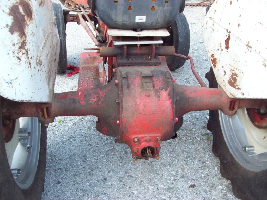

No top cover just some fabbed up steel with pieces out of the side to hold the forklift. Pump cover looks standard but we'll see when I open her up. PTO seal is leaking. Just planning to unbolt the back half of the tractor and roll another one into place. will only have to change one gasket.

Got to split the '51 beater. Drained out all the creamy color fluids.Unbolted the steering box and moved it up about 3/4" just to see if I was lucky enough to get another sherman. But no such luck. I kind of figured the sherman was long gone by the bolt head on the side of the case where the combo lever was but I had to check anyway. Went out back and located a parts tractor, took a hand crank with me. Engauged the pto lever, clutch out in neutral, spun the engine with the hand crank and the 3pt arms came right up. I wanted to make sure it worked before I moved everything out of the way and went through the trouble of splitting it.

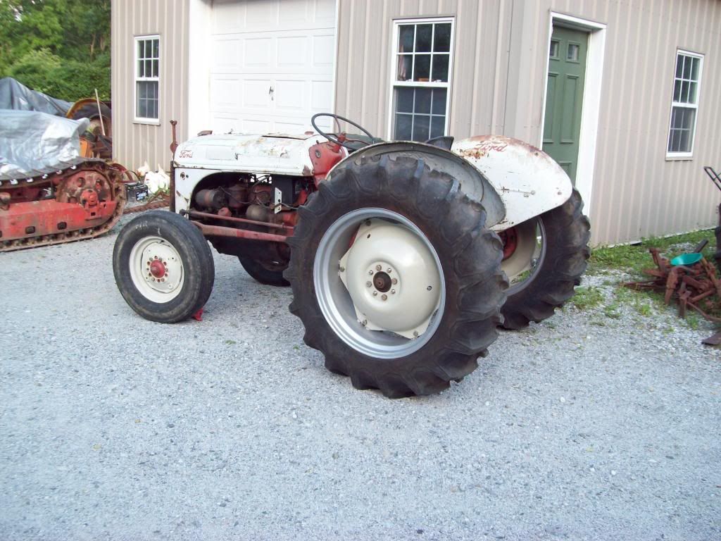

Split the other tractor Saturday clean it on and after cleaning out the other one made the install. Fill the fluids this morning and hooked up the 3pt loaded platform. Picked up the 3pt and shut the engine down. Returned in about 4 hours and it hardly moved. I took it for a ride and hit the brakes which weren't stop. Decided before taking the drum off I would try to ajust them. Much to my surprise they came right up and stop quite nice. I also changed the black engine oil. Still have to put a new tube in and put the fenders back on and ad a tool box but this project is quickly come to an end. I might power wash it before I take it up state But no paint will be added to this baby. Riding in the overgrown woods would destroy the paint in a couple of passes.
Photos are of my friend Bill giving me a hand with the install and the tractor with the loaded platform

Forgot to mention that the old housing did have a hydraulic pump in it. It appears to be in good shape. The lever that controls the 3pt had to be freed up from non use. My friend Bill is going to use it on one of his projects.
